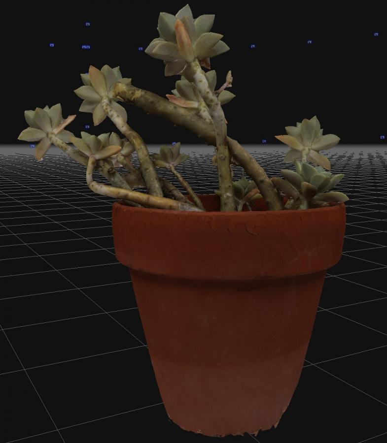

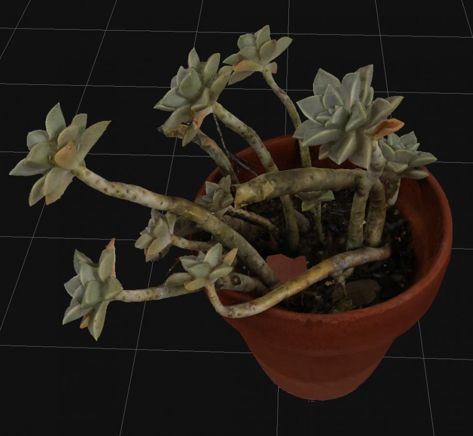

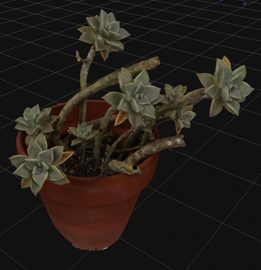

    Regardless of the masking issue - the plant I took pics of turned out pretty damn good
ID:	2322Click image for larger version
ID:	2323Click image for larger version
ID:	2324Click image for larger version
