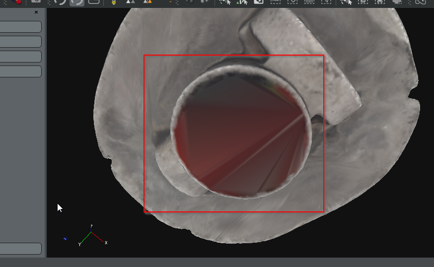

    Hello Forum,
    I attached a screenshot down below.
    I used the tool "Fill Holes Selective" to fill the red marked place at my subject.
    But this holes was filled with a red colour (see screenshot attached).
    Is there any possibility (tools etc.) to color this place grey as the whole subject?
    Thank you in advance
    Hi Furkan,
    Unfortunately, it's not possible to color the vertices manually in Zephyr. You can do it with standard modeling software (also in Windows Paint3D I guess).
    Zephyr assigns a red color to the triangles because there's red color in the boundary vertices before the filling. You can try to eliminate the red border vertices or find in the photos the red part and mask them, altough it would be much simpler to adjust the color manually.

      Hi Furkan,
      you need to do that in post production unfortunately. I suggest you extract a texture, create your own custom UV map, regenerate the textured mesh using the custom UVs and then edit the texture in the area you'd like to change color.
