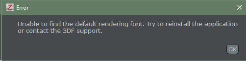

    I just installed the free/trial version of Zephyr, but it just gives me the error above in a dialog box and quits. I tried manually installing DefaultRenderingFont.ttf, which didn't help,.
    Any ideas on how to get it working?

      I'm using Windows 10 pro. The behaviour is that when I try to run zephyr, I get your loading icon which displays 'initialising rendering', etc, but then a dialog box pops up saying that it is 'Unable to find the default rendering font'; and when I dismiss the dialog box the program exits.
      Though actually, I just rebooted, and instead I now get a 'fatal error while loading shaders', but at least it starts the app now!

          I don't have any antivirus (I'm adamantly against them!), and I had tried re-installing before posting. This morning the font error is back - here's a grab of the dialog if it helps:

                          Has this been resolved? I'm having the exact same problem. W10 Pro Evaluation Copy (could this be the problem?), Surface Pro 4, declined the default viewer for 3D models (just in case that could have anything to do with it). I can find the Materials folder and I do have the default rendering font, which I've also installed manually. The 3DF Masquerade app worked fine (and was excellent by the way!) but I still can't open the main software without this error message. Any ideas?
