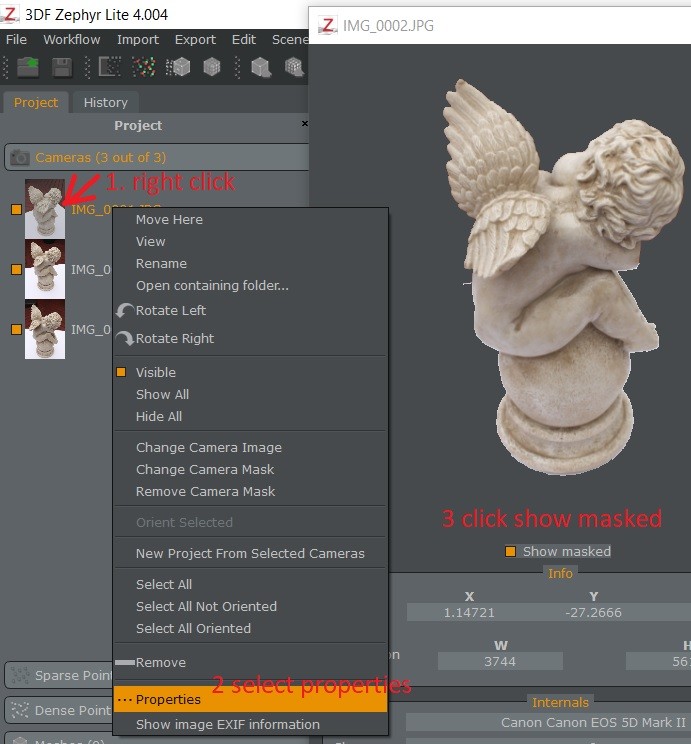

    If you doubleclick any camera in the left panel (or right click -> properties) you can directly see the applied masks on the image in zephyr too.
    Edit: or, maybe you meant to see the actual masks we used for that dataset? I may have misunderstood
    Click image for larger version  Name:	maskinzephyr.jpg Views:	1 Size:	94.2 KB ID:	3115

      Thanks Andrea. "Fill all holes" is exactly what I was looking for. I'll experiment with this.
      Perfect re the masking - on the Dante statue model. But when I look at my own project photo's, it shows a different screen (with no "Show Mask" option). Is this because I'm using RAW (ARW) files? Is there any way to do this for RAW photos? (I was trying to add a screenshot, but I couldn't paste it sorry)

        if you don't see a "show mask" option, then you do not have a valid mask used in your project. Make sure to check "Mask images" in the project wizard when starting a new project, even if the masks are already on the hard drive.

            Hi Andrea, I reran the project. Making sure that I selected that I wanted to us masking, but not during SfM. The result was exactly the same (the project model and the properties screenshot - right click on photo, select properties, no option to select mask). I am going to try two more attempts again, the first to include the masking in SfM, the second to stop stop after the first step (and right click on the photo at that point so that I can check the photo properties screenshot).

                  I confirm there is currently a bug with .ARW files and masks. This happens because the exif data height is incoherent with the height computed by zephyr. This is expected when dealing with raw formats (as they have a variety of information) and depending on the demosaicing algorithm used, the final size of the image may vary a little.
                  we have fixed it in our internal build and we'll publish a patch soon (hopefully this week).
                  At this moment, your masks are completetly ignored. As a workaround until the patch, you can convert your ARW to JPGs.
