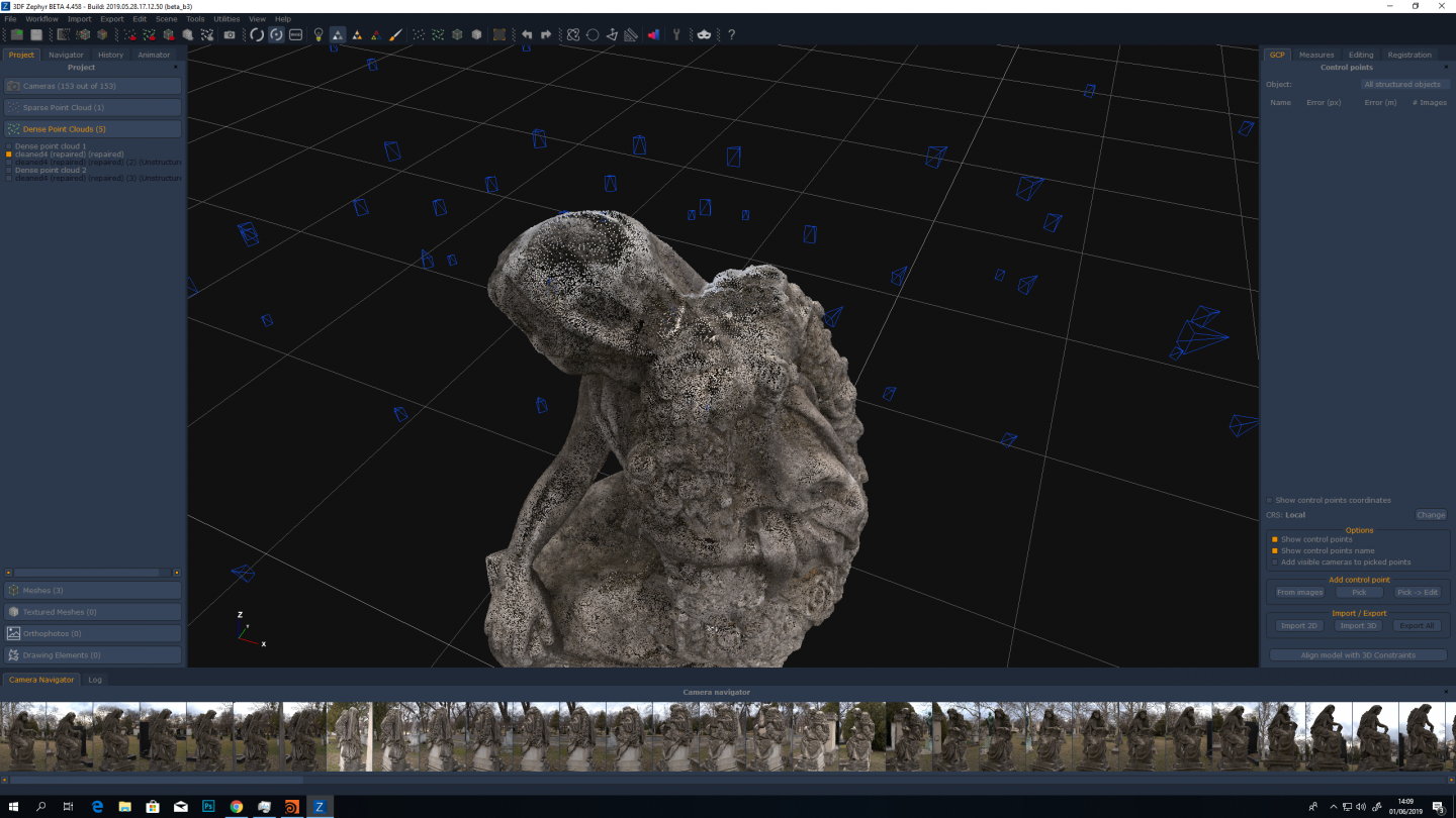

    alignment, point cloud/ dense point cloud, mesh construction, texturing all goes perfectlly, I recognised no issues beside some mesh structure anomaly, but I do not wanna focus on that right now, any way, I can fix it in no time externaly.

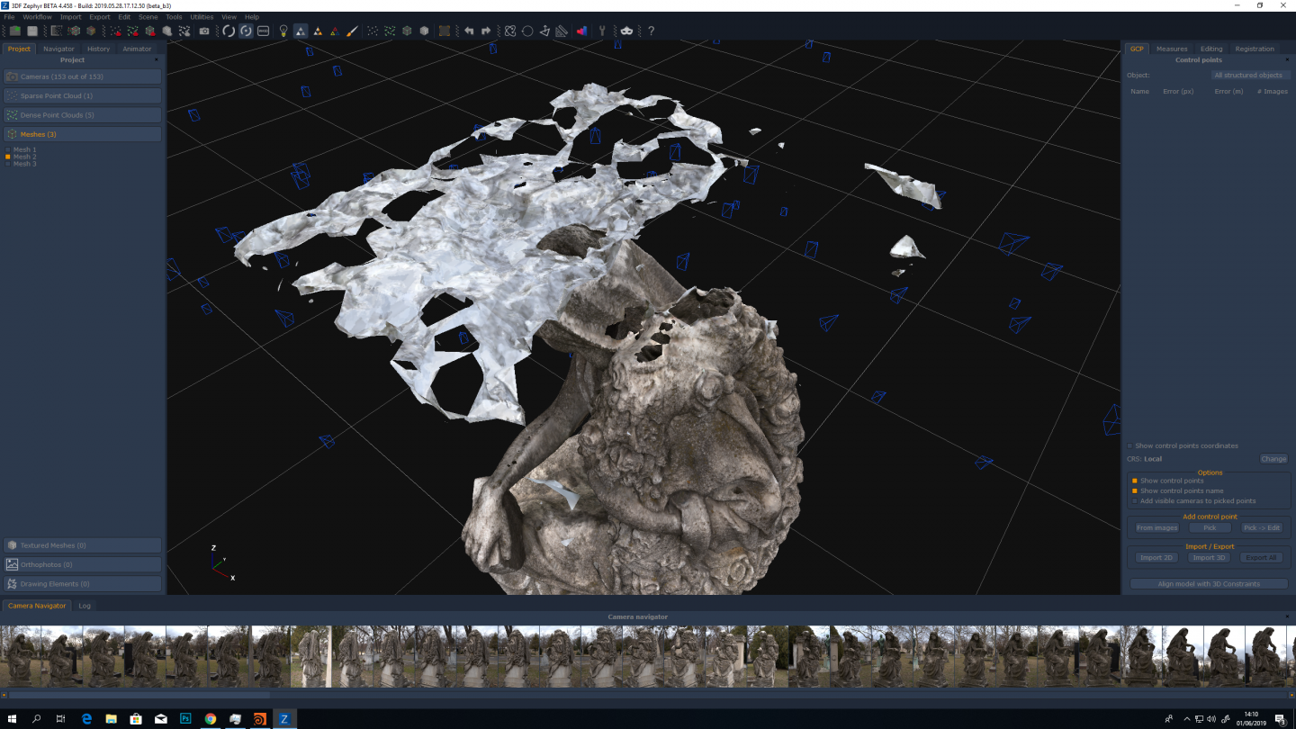

    if I export the mesh for external cleaning, there is no way to import it back, at least not with the full cleaned up surface.
    - I do not rotate or scale or move the mesh in my external tools.
    - if I want to import back JUST the mesh without self generated UV(s) Zephyr will import it as a dense point cloud and not as a mesh
    - the imported pointcloud already lose some information that I generated till the cleaning process
    - by constructing mesh from the importing pointcloud ignoring nearly all the cleaned parts and I end up with close the same broken mesh with holes and missing details as prior the cleaning process
    - if I want to import the cleaned mesh with UV(s) it handdles the import stage, but the texturing stage crashes 10/10

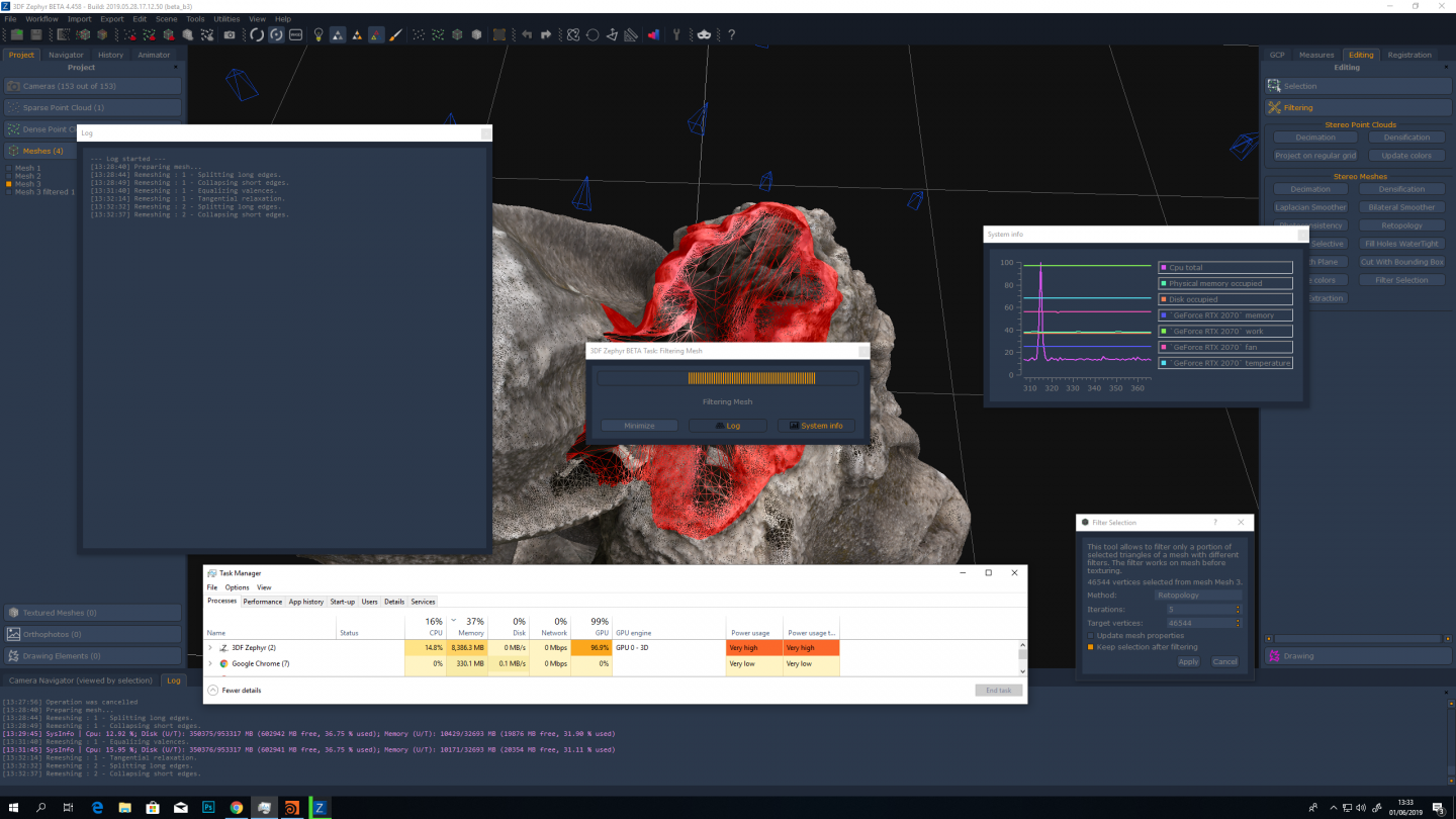

    - I tried to fix my mesh errors by filtered selections, but by selecting 3% of an 1mill mesh for applying a retopo stuckes in the process for an hour, so I simplly just shoot down the software (it should be like 2 min imo) quite the same scenario with every even filtered selection process.

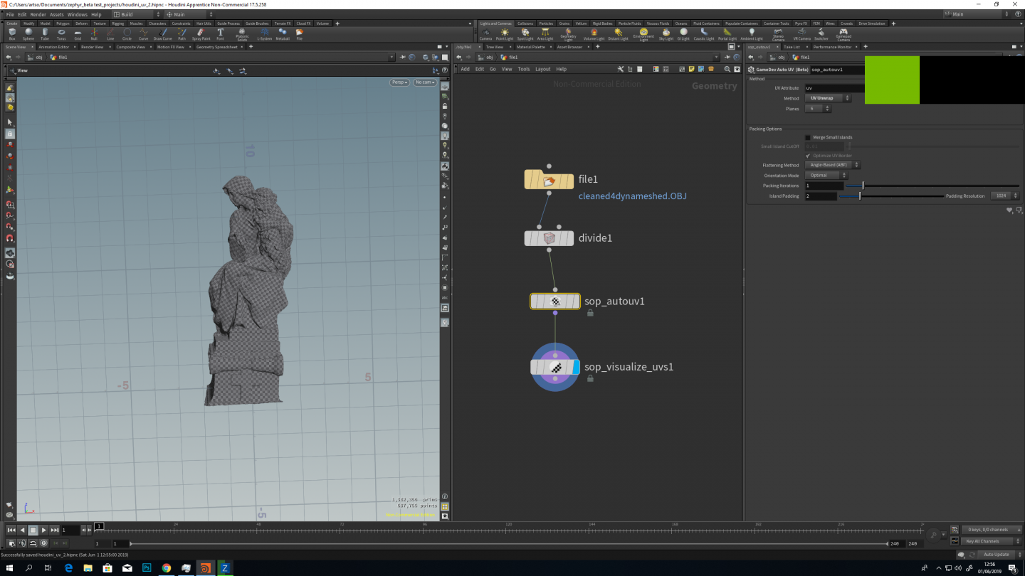

    - imported to netfabb for fixing every even mesh degeneration as shells, flipped normals....
    - imported to Houdini for triangulation and for UV generating
