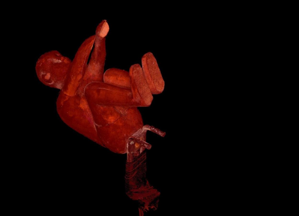

          Snek - when you say you took 49 pictures, do you mean screenshot or actual photograph?
          Couple of other things I'd like to add - There is potential for the masks to be inverted, so might actually be stripping out the subject and trying to reconstruct from the background alone. In Masquerade RED is the non-masked, and blue is the masked (image attached for your reference).
          The other thing was, 50 or less images is fine for feature rich subject matter, but if your subject is less than ideal for camera orientation, you can always demo one of the paid versions of Zephyr for 14days - Personally I take a minimum of 144 images for a full 360 capture, usually more, rarely less. https://www.3dflow.net/3df-zephyr-ev...download-page/ (Lite enables you to use up to 500)
