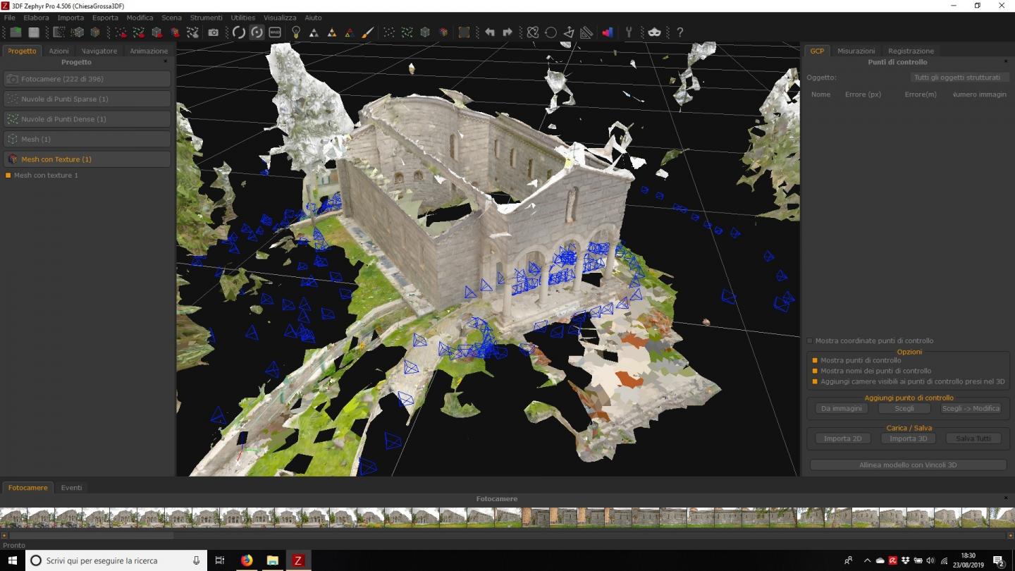

    Hi all,
    i'm writing because i haven't yet solved a problem, even if i tried with every tutorial on the web.
    I took 222 pictures from the ground, with a mirrorless, and 178 pictures obtained by extratcting frames from a clip recored with the drone.
    It seems that 3DF recognize two different models without matching one with the other.
    I thought that CGP (from images) were supposed to be used in that case, but i can select just the images that generated the model.
    Which is the right way to force the matching between this two models?

      Thanks for your kind answer cam3d, i'm using 3DF Zephyr pro 4.5, and i resolved the problem in a way i can't find very smart...
      As i read in the forum i built two different models, one with the drone's pictures and one with the mirrorless's pictures. I inserted 4 CGP with the same name in the two models, and then i imported the second one into the first one.
      I mean, is possible to do that in the same .ZEP file, isnt't it?

          Hi Marco,
          that is actually the correct way to do, as at this time you cannot place control points before processing the SfM phase
          An alternative is to shoot more picture that helps the automatic fusion of the two workspaces - likely, there isn't enough overlap between the two projects, hence the need to use control points (which require 2 workspaces at this time)
