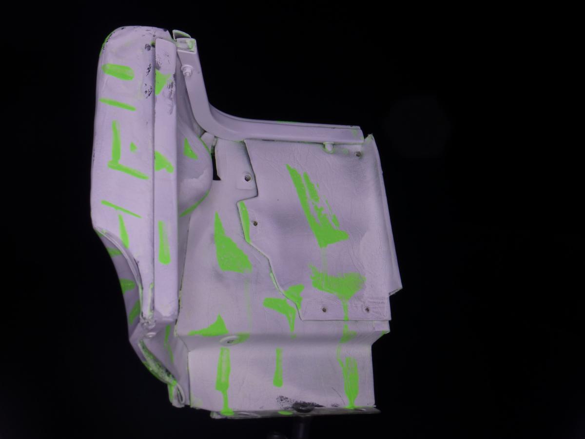

    New to 3d Zephyr. Downloaded free version. Practicing with various photographic setups. DMC-ZS20 camera. Finding limitations with camera. Ordered Nikon D3500 with 60mm low distortion lens. Built a light ring. Aiming to 3d print a dashboard component 10cm cubed. . Black vinyl so sprayed with chalk paint. Even shot at night with light ring and darkness outside. Mixed results. Found best not to fill the view completely with object so that DOF is increased. Trying masquerade but windows just spins circle for 5 seconds and nothing. masquerade.exe is in directory. Shortly will need to buy 500 photo licence.
    If I can successfully print this cube part then move to print a complete Alfa Dashboard. Then many car parts and body.

      Checked and disabled virus detection. No change. I have full administration rights. Any tests ? Should I uninstall and re install? Any log file??? Win 7 64 Bit
      A night photo attached
