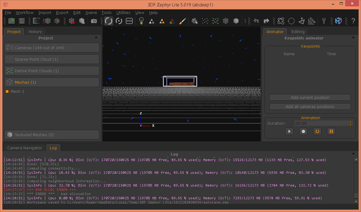

          Im beginning to think its hardware as zephyr reported bad alloc error in the log...
          or is software?

                so are you suggesting that I ignore the "bad alloc error" appearing in the attached file above?
                  Hi Roger, I believe it's a lack of RAM and using settings which demand more which is causing the allocation error. Using a higher spec'd machine or using lower quality settings should mitigate this issue.
