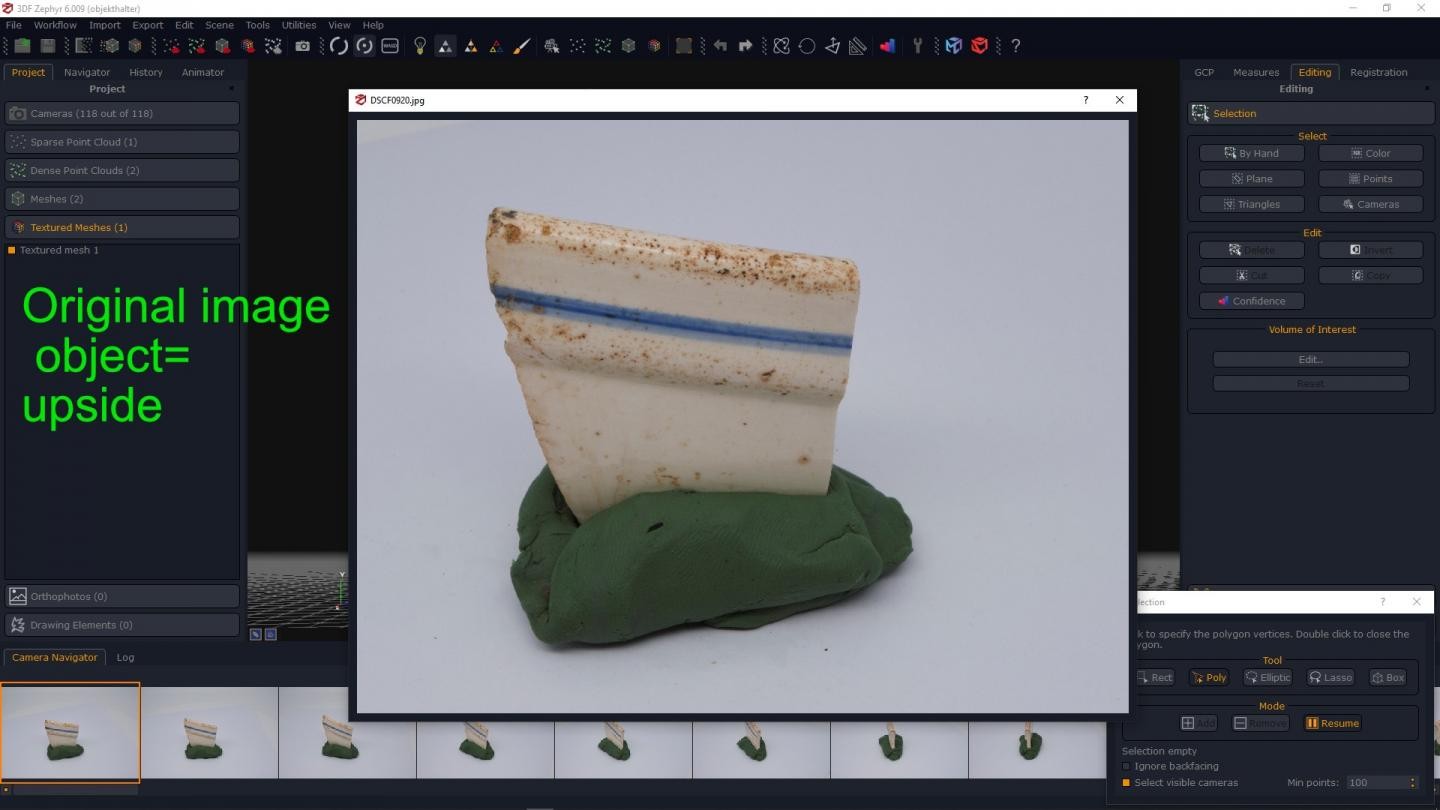

      Hi cam3d,
      thank you!
      I apologize, I did not mention that I know masquerade and work with it.
      But the result is unsatisfactory. (just for projects with holder, masking of objects that can stand alone is no problem)
      As you can see, the green edges remain from the plasticine, even though I masked everything.
      It seems as if, despite the masking, the paint shows through at the point where the plasticine holder was.
      What can i do to get clean textures?

            jupp2000 Regarding light changes - think about it in terms of:
            Your current lights are in a fixed position, your subject is moving - There are subtle differences in intensity and shadows will be cast and move across the surface of the subject as the light is bouncing and multi-directional. For example, you can see shadow on the area under the blue line, but when this is rotated, your currently lighting setup will then not have a shadow there. (Reference image attached).
            With a ring light you're not bouncing light around, rather you are targeting it directly onto the surface. There is no need to illuminate a whole object because the camera can only see one side of the subject, so it makes sense to only illuminate the subject from the perspective of the camera. As a result of using a ring flash instead of bouncing light around you will suppress the shadows evenly every shot, and you can use a black backdrop, black surface and black support to further suppress light bounce etc... I find that black works for 90% of the work I do, and a dark grey is a good alternative if the subject itself is black, so it's easier to separate the subject from the rest of the image using mask by colour in Masquerade.
