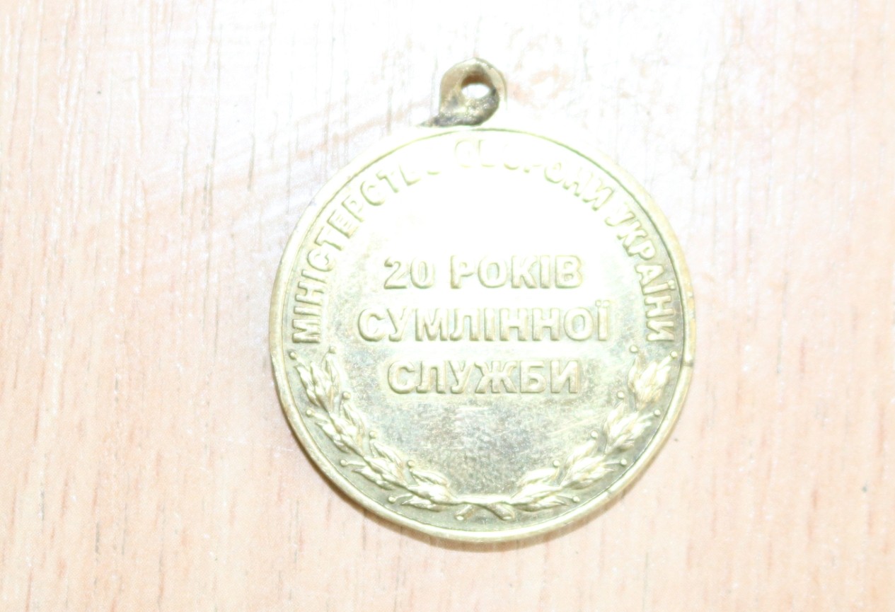

        If you struggle with reflections from metal parts - try to play with cross-polarization. What I did was to buy circular polarization filter for the camera lens (I've bought a cheap used CITIWIDE CPL 58 mm for around $5) and put a piece of polarization foil in front of the light source (I've bought a sheet of polarization foil for $7 from a guy, who repairs smartphones).
        Even without external flash, with just a small piece of the foil duct taped to the built-in flash of the camera (I used Canon EOS 750D) the results are very impressive.
        Here are test photos with direct flash (shot from ~30 cm) without and with cross-polarization. Click image for larger version  Name:	Screenshot_1.jpg Views:	0 Size:	166.0 KB ID:	8319Click image for larger version  Name:	Screenshot_13.jpg Views:	0 Size:	334.6 KB ID:	8320
        Hope that helps.
