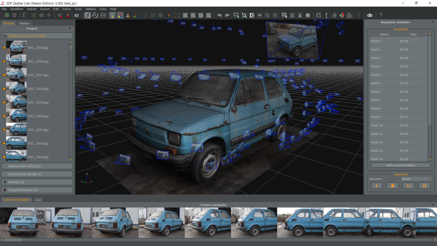

    Hi there,
    I apologize if this is explained somewhere but I could not find it. I am trying to show photo thumbnails within the blue camera boxes that float above my model. This is shown in several of the images used in the tutorials, but I cannot figure out what settings make this happen. See the image below. I would like to reproduce this but using one of the models I've generated with Zephyr Lite.
    Thank you!!
    Jamie
    Hey Jtesta You can force on the floating thumbnails through Tools>Options>Appearance and deselect 'Load cameras thumbnail only on demand in 3D space'
    Once deselected, next time you open up Zephyr all the thumbnails should be there floating in space.
    • Jtesta
      • Nov 2022
      • 10
      Thanks so much!
