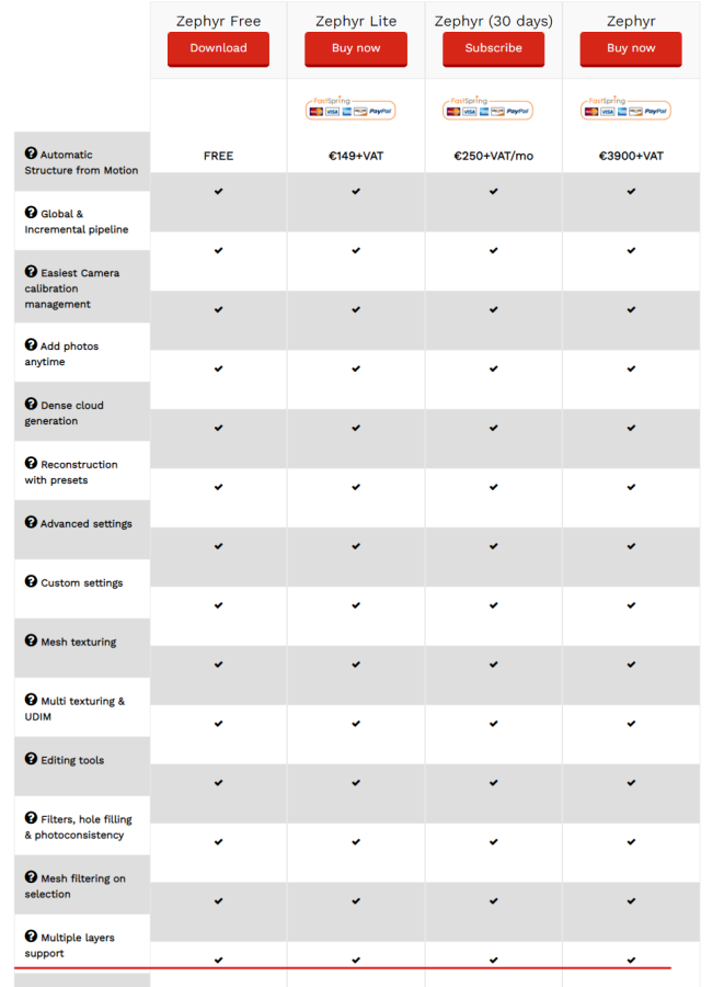

      The spec sheet appears to indicate that this feature is available in the Zephyr (Lite), but is this a misnomer?
      Or does this refer to a different feature?
      ?Click image for larger version
        • 1369
        Hi Kyo,
        thank you for letting us know. It's indeed an error that was probably introduced when we last updated the table. Apologies for the confusion.
        The free version does not have multiple layers support at all, and that is an error in the table.
        The lite version offers a single "change workspace images" functionality (so basically a way to swap from a layer to another, e.g. photos with projected pattern / photos without pattern)
        The full version offers the above, plus the full multiple layers UI/functionality.
