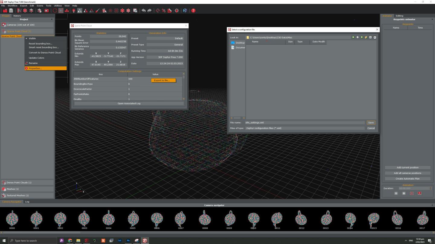

    XML export reference screenshot attached :-)
