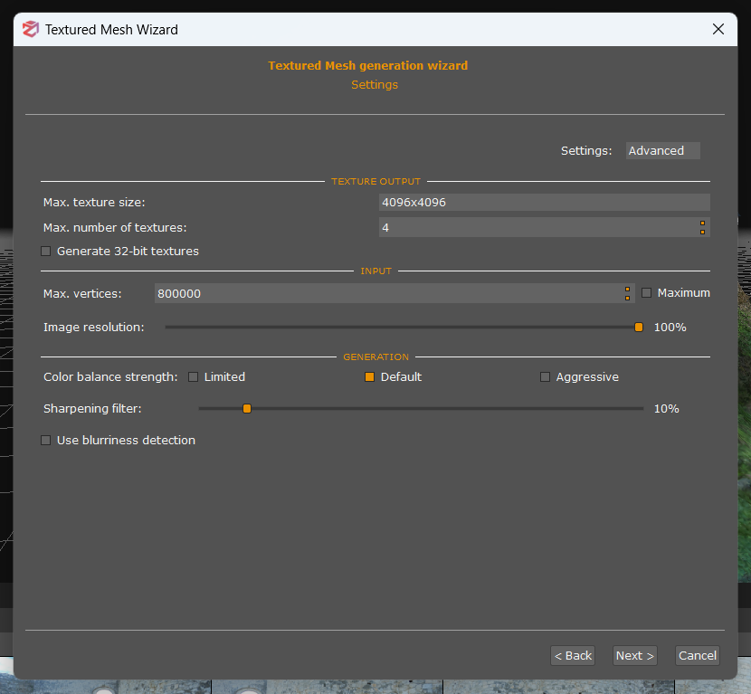

    Hi m3vbih -
    It sounds to me like the issue is as follows:
    - You make a (non-textured) mesh, you decimate this mesh to 600,000v
    - You then make a NEW (textured) mesh, so it doesn't really matter that you decimated the other one, a new mesh is created, with it's own properties.
    Solution: Restrict the textured mesh max vertices in the advanced settings of the textured mesh generation wizard (ref image attached).

    • m3vbih
      • Dec 2023
      Tnx, sound as this was problem.
      Will try this when I get home.

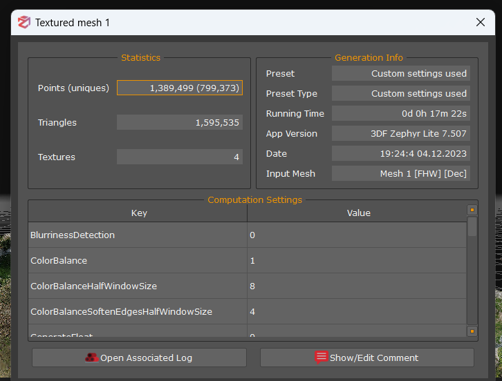

      • m3vbih
        • Dec 2023
        I tried what you suggested but still I don't get exact number. Or maybe I do but something else I miss:
Name:	Snimka zaslona 2023-12-04 190232.png
        but textured mesh says:
        And 1.389.499 is number that is reported when I try to upload.
          The number in the brackets (799,373) is the vertex count. You can open the file in a program like MeshLab to confirm.
          NOTE: Apparently not for GLB :-(
          Click image for larger version  Name:	final.png Views:	3 Size:	48.5 KB ID:	9331

            • m3vbih
              • Dec 2023
              Every 3rd party viewer of glb file reports number outside of brackets 1.389.499.
                • 1372
                Hi, I'm unable to replicate the issue?
                It's vertices (unique) so it just might be that other software don't count unique vertices by default.
                  Opening in MeshLab vertex count is different for GLB/Meshlab (same mesh exported from Zephyr in each format) - I'm thoroughly confused.
