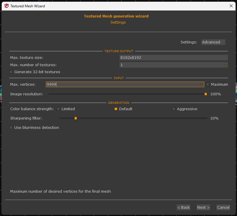

    Hi Sayeed khan
    When you create your textured mesh, drop into the advanced options and set your max vertices to limit the size of the file. You definitely don't need such a high polycount, especially if it's going to end up as a unlit textured model.
    • Sayeed khan
      • Oct 2022
      • 23
      can you give me an idea upto what vertices count should i set to can get .dae ,+ jpg close to 500mb size
        • 687
        Hi Sayeed khan I don't know the specific polycount to MB conversion for .DAE - To solve this for yourself, I recommend going really low (512,000 or so polygons) and seeing what size that is. Then you can either up the polycount if you have the headroom, or reduce the count further for greater optimization
