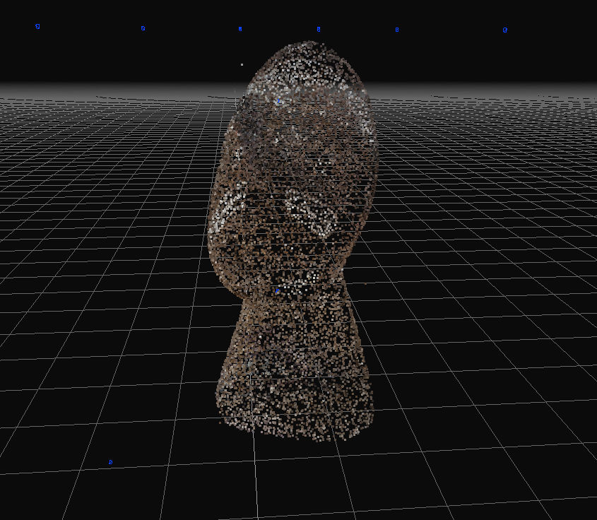

    im trying to create a model of a small rock.I have added 280 pics taken from a video.Now,the video was shot from above and around the object,and the underside was shot by turning the object bottom up.
    I can see the program detects all camera angles as being from above and around,but not bellow the objects underside.
    Hence my problem.The program uses the added bottom side pics but just adds them to the existing mesh without knowing they are supposed to go on the underside.
    How do you get around this? cause the only way i can think of is to shoot it from below whille its sitting on a glass surface or something.
    bare in mind i havent had any problems with the backgrounds.I use a turntable with a sheet of text stuck to it and it seems to be working fine.Ihavent had too much trouble removing unwanted points from the mesh.Seems to me ive done a pretty good job removing them manualy,at least on this simple subject,but the underside is really getting me stuck.

    Just as an update,my problem got magicaly solved just by changing the background on the turntable from something with features to completely white.This goes against every photogrammetry video i have seen so far i think,but for some reason i dont understand it worked fine the first time.the program sees the subject as elevated or something and puts cameras on the underside of the subject too.
    i will try it again,but i was very pleasantly surprised cause i wouldnt have slept last night if i didnt get it to work
