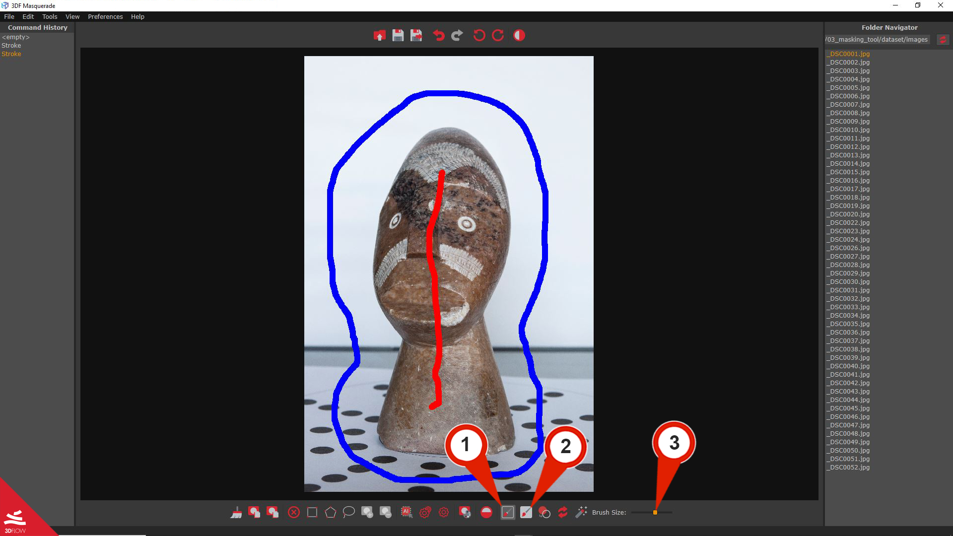

The Brush tools (also known as the Silhouetter tools) are used to manually create masks or refine those generated by the Automagic tool.
3DF Masquerade uses its algorithm to propagate the mask automatically, leveraging the strokes provided by the user. High contrast between the background and the subject improves the tool’s effectiveness in generating accurate masks.
The tool requires at least the following strokes to function:
- Foreground stroke (red): areas marked with the red stroke will be included in the mask.
- Background stroke (blue): areas marked with the blue stroke will be excluded from the mask.
To start using the tool, click on the “Foreground stroke” (1) button to activate the red stroke, then left-mouse to mark areas of the image. To mark the background, either click the “Background stroke” (2) button or hold the “shift” key drawing with the “left-mouse” for applying the blue stroke. The brush size can be adjusted using the Brush size slider (3).
Clicking on the “Compute mask” button
will generate the mask propagating the stroke, additionally the Automated Masking after each stroke command
can be enabled to compute automatically masks after each stroke applied to the image.
